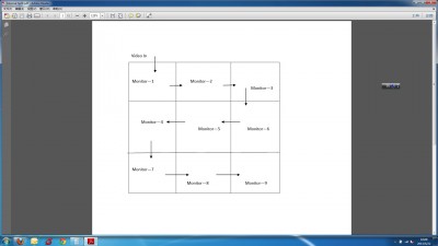

The resolution I plan to use is 12288*2304, that is to say 1024*768 for each monitor. A high-end workstation equipped with ATI Firepro W9000, do you think one set workstation of this configuration is enough to process 12288*2304?
Internal split function, this is my first time to hear that. I draw a pic from what I understanding, pls check the attachement. Do I understand correctly?

your sketch is ok but i think the maximum input resolution of a cluster lik this is 1920*1080 (maybe 1920*1200) what should be enough out of a distance from 6-10 meter!
your total resolution would be: 7680*1080 what is no a big problem....but depends on your show!

yes i mean 1920*1080 for each of the 4 clusters. you have 4 cluster 3*3 so you have a total resolution of 4*1920/1080 what is in total 7680**1080px
