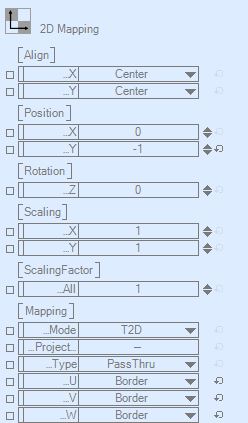

Most impotant thing to change is:
Node: Live Video -> 2D Mapping -> [Position] ..Y = -1 !
See attached screenshot for the 2D Mapping Parameters of the Live-Video node.
