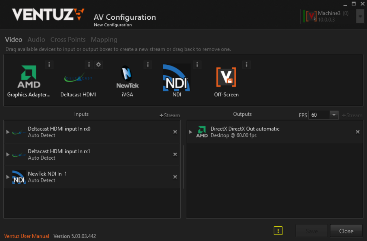

Re: Embedded Audio from hdmi capture card
I have audio in Deltacast software (dRec) but not in Ventuz.
Nothing to configure in configurator edit...
Someone can help me ?

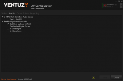

If you want to have audio from the capture card come out of the windows audio output device, make sure you enable the windows audio output device in the "audio" section, then add a crosspoint from the capture board to the audio device.

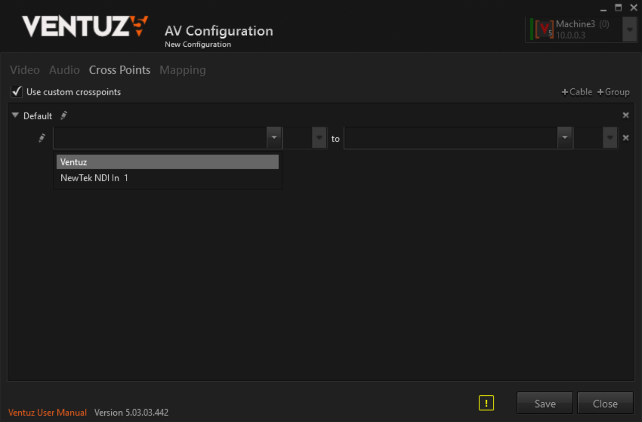

I don't see the hdmi capture card in the crosspoint section !
Hi Remi!
We did a mistake. We misinterpreted our own documentation.
The information about the audio capturing in this thread was wrong!
We ONLY support audio capture via Blackmagic HDMI boards.
We will evaluate how complicated it is to add audio support for Deltacast and add it for 5.3.4 if possible.
Which board do you have exactly?
I'm very sorry!
I'm very sorry!
I have DELTA-h4k-elp 20
