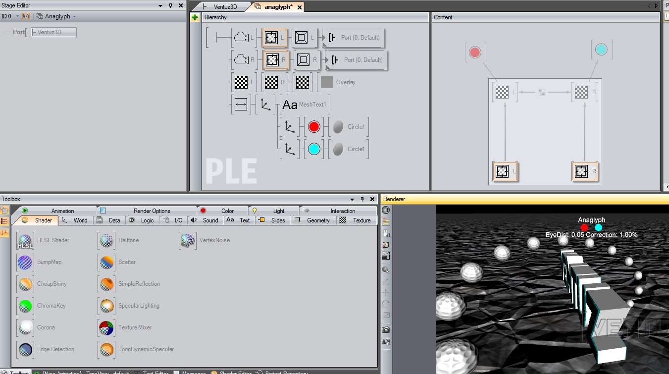

I played with the stereo3d example which I found in the forum archive. http://forum-archive.ventuz.com/forums/ ... wPost.aspx
I changed the colours to red and cyan.
But I do not receive a red/cyan output.
Why?

Hmm it is working fine for me here.
The project is seperated in Content scenes and Layout scenes.

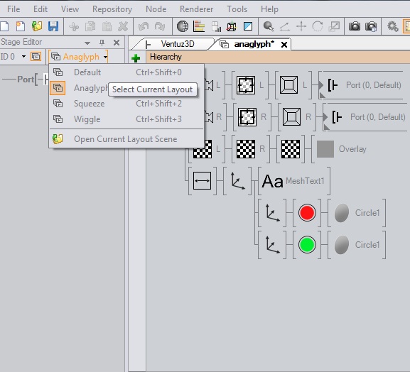

The anaglyph scene is a layout scene so what you need to do is:
  • Open the project
  • Open the Ventuz3D scene
  • Open the StageEditor (View-->StageEditor)
  • Select the anaglyph Layout scene
  • To edit the layout scene use Open Current Layout scene
Read the Scene Management UserManual page for further info.
Cheers!

Are you sure you kept the binding between the Color nodes and the Texture nodes that are called R and L?

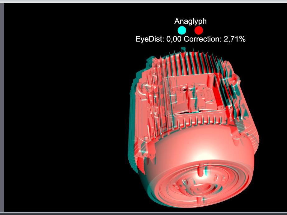

Solved. On bigger machine comparaed to my notebook everything is ok. (see atachement)
Thanks.
Did anybody suceed floating the object in front of screen? Played long with the convergence parameter (correction). No success.
