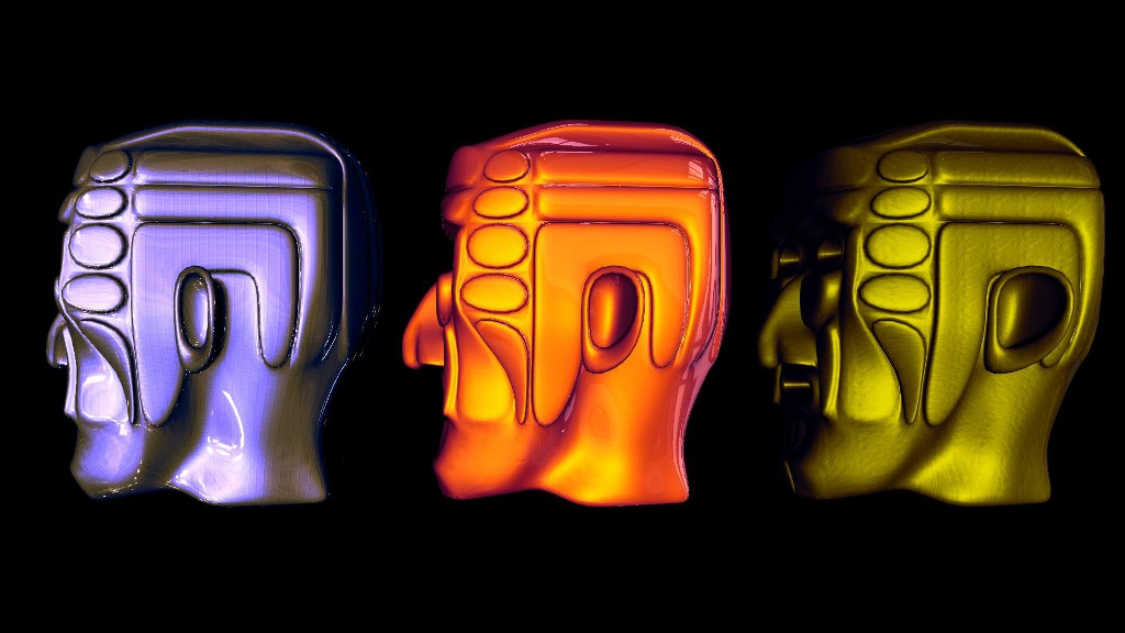

Re: Shader Thread
Kind of dual-layer metallic shader - taken from ATI demo.
Your geometry needs proper UV coordinates!- Attachments
