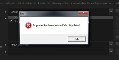

This DVI input card works fine under Ventuz 3. Unable to configure under V4. Just gives an error...
Driver 7.4.0.502
Dated 21/8/2013
Windows 7
Peter
Have updated to latest drivers and Datapath viewer application is working fine.Hello Ventuzians!
Unable to Configure Datapath RGB-E1

Same issue with the DATAPATH VisionHD4 capture card.
Am able to is disable and enable the cards inputs in device manager to coax it into working for a brief amount of time in V4 but its a process. Seems to work fine in V3

Problem reproduced and fixed (in the next release of ventuz)
