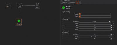

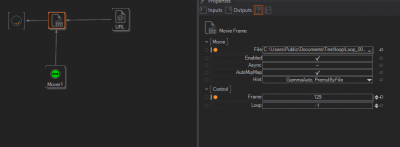

I faced a problem with a Movie Frame node.
For some reasons it is not running frames after 140 frames.
I have a *png sequence with *151 png files. I connected Mover node to the the Frame inside Movie Frame node. Mover is running from 0 till 150 but actual picture stops at 140
Here you can download my *png sequence -https://www.dropbox.com/s/fe7er13k1xocw ... q.zip?dl=0
I tested it in Ventuz 4 and it worked smooth but with Ventuz 5 I have a problem
Please check my properties for the nodes below

Re: Movie Frame
Hi all!
We can reproduce the problem with another image sequence.
It seems to be related to multi-threading. If you disable 'Threading' in the MovieFrame configuration it works again.
We will try to fix it for the next update.
Best Regards
