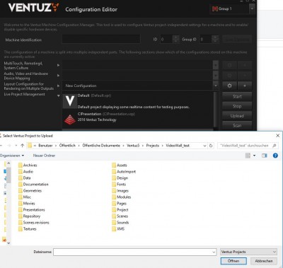

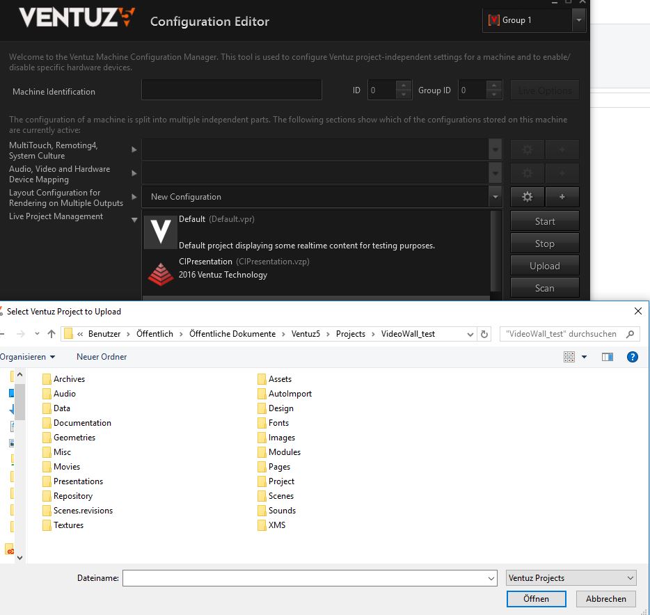

I created a group cluster with many monitors. Under that window i want to upload a new scene. Sadly this doenst work.
My main project folder is in the default ventuz folder.(where hockey and CPI sample projects are also to be found )
If I click on Upload, the browser file window opens, then i go inside the main folder, and i dont see any file to select. But the project file is actually there.
what can I be missing?
Thanks
Upload Project into the Configuration Editor
Re: Upload Project into the Configuration Editor
Hi!
The upload only works for VPRs or VPAs.
