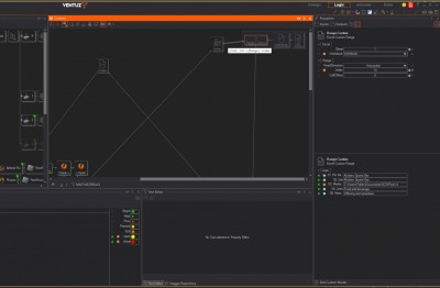

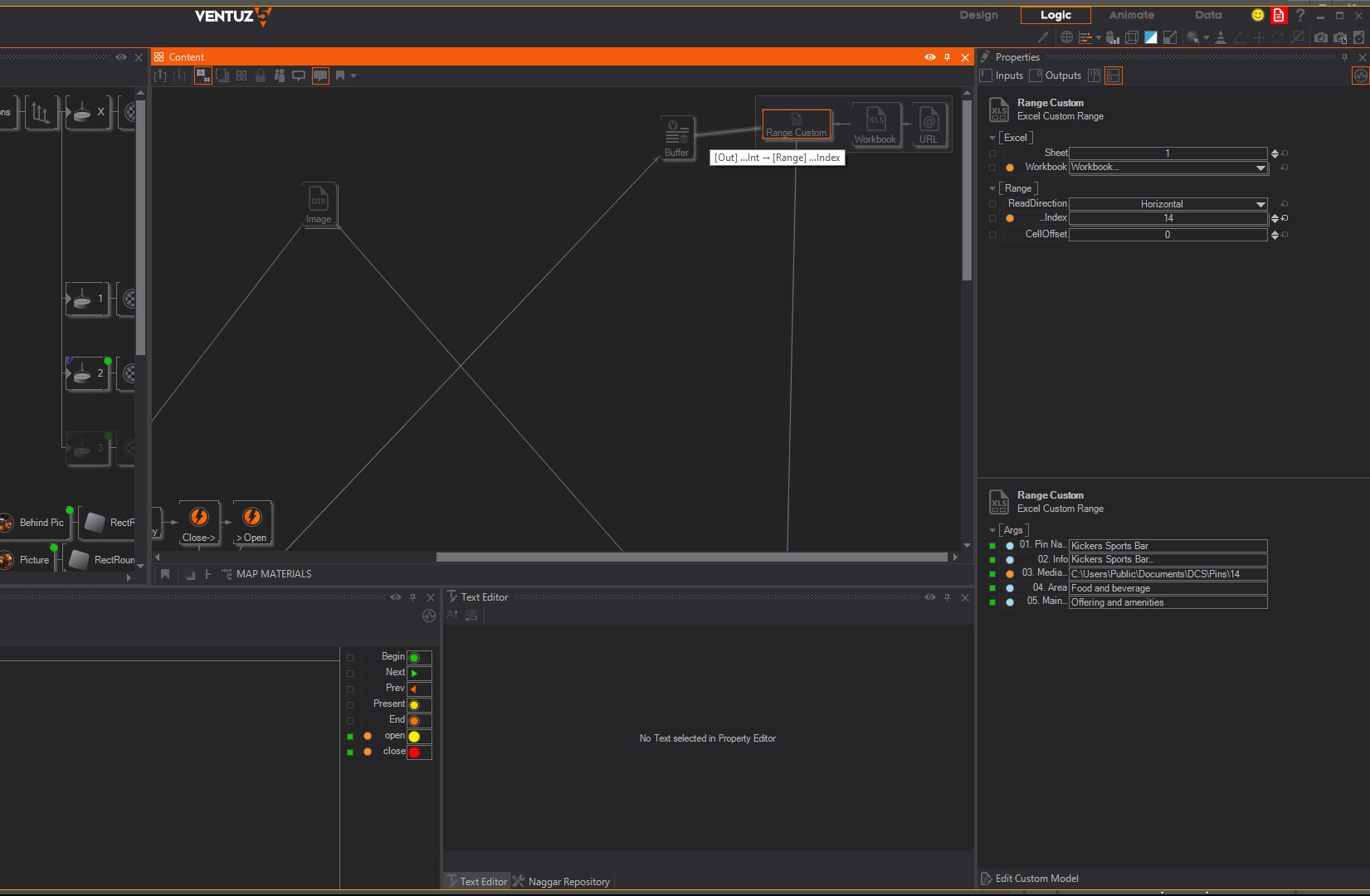

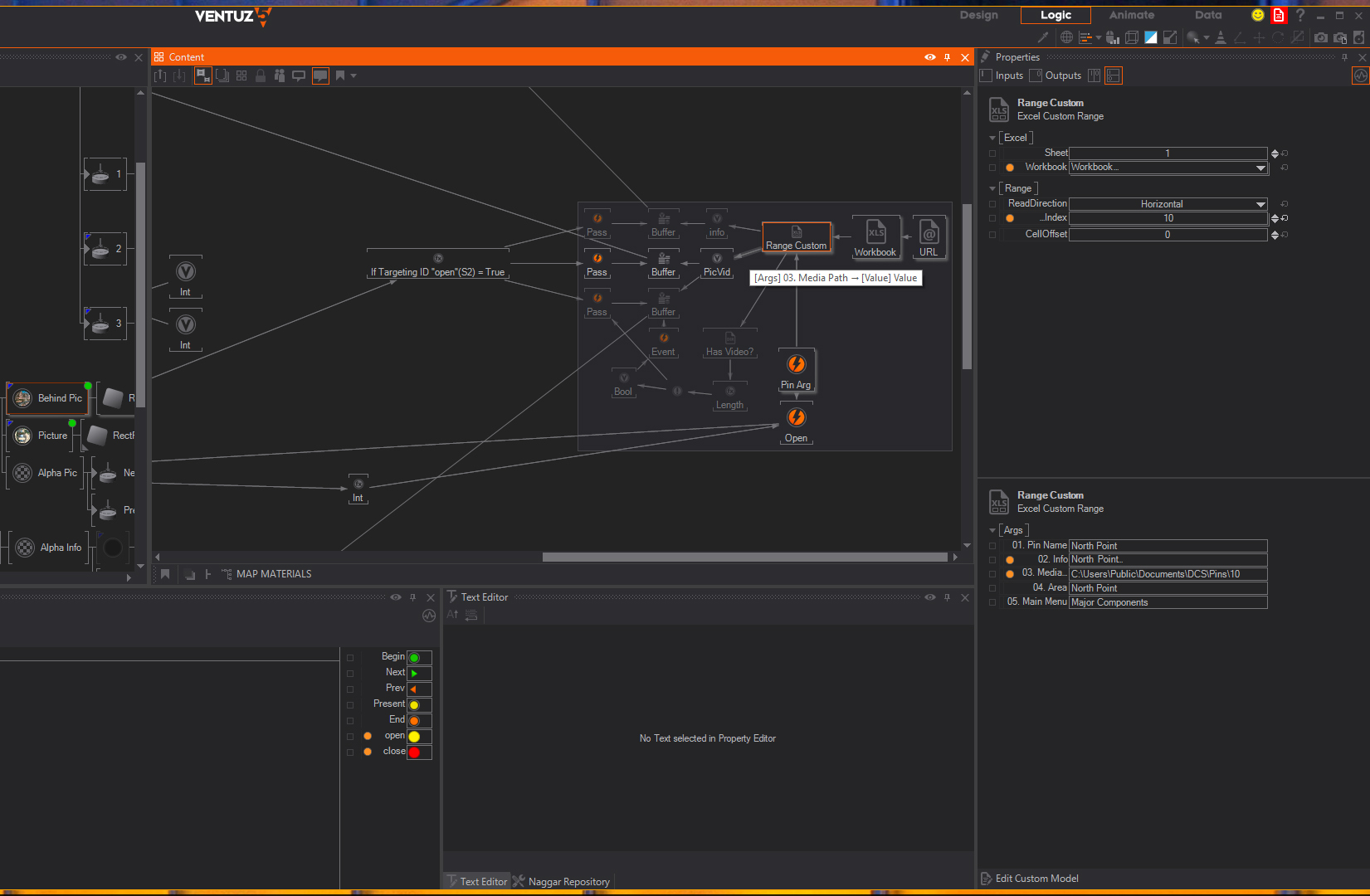

So in practice: what I have is an excel workbook and custom range node with 3-5 outputs (rows).
My first method (see attached: incorrect.jpg) was to connect the value buffer (int) to my range index of the custom range node. and the lag obviously happens whenever buffer passes. the lag would take about 0.2 - 0.4 seconds because it was changing all 5 outputs at the same time so it was noticeable. (also im not sure about this but, Connecting the properties to scene data might also cause lag)
My second method (correct.jpg) I connected the seperate outputs of the custom range to individual buffers and added 2f delay between each pass.. this way the lag was barely noticeable.
Still not sure what is the root cause of the lag. maybe reading from excel itself. but for now I managed to solve the problem.
