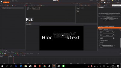

I import thai font to ventuz but it don't show up how to fix it?
Thank you

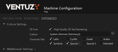

You need to add the char set:
Open the Ventuz Config Editor. Create a new Machine Configuration (first block: MultiTouch, Remoting4, System Culture). Go to the extended tab and check Special 1.
cheers,

It work thank you.
