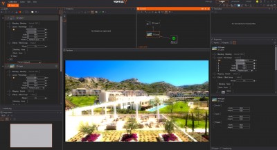

Re: Binding properties of two different layers in Ventuz
Well you can get the "layer interconnections" visible by just clicking on a "layer" (not the pencil). You will see in the Content Editor: "Layer Level" in orange.And for my brain I miss the visualization of logical connections between layers (menues not found yet?)
If you have bound properties between layers, you will see the "bindings"... same goes for the content nodes, which are bound to the Layers. If you bound a Mover to any of the Layer Properties... e.g. "Layout -> percentage -> X" and you click the layer level, you will see the bindings, node, and even the "layer" as a node...
Hope that helps a bit
Have a look here:
i bound the X of the 2D Layer to a Mover, bound the X from the 3D Layer to the X of the 2D Layer..
in the Contentarea you see the bindings...
Best RegArts
