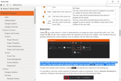

Just click in the empty space of the Hierarchy editor... where you have all the nodes always deleted...
Press "F1" and select : "how to use the Hierarchy Editor" ...
This will open the Help .. Manual...
in the middle of this very basic help document you will find this: .. Sorry i couldnt resist since you wrote "Ventuz's help documentation does not explain how to do this anywhere I could find,..." xD
Here you go
