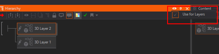

Interfacing Layers:
You can :)
But this is a bit advanced.. you would select the "Hierarchy use for Layers" option - which can be enabled by clicking the "Eye" icon in the Hierarchy Editor Window.
Just enable the "Use for Layers" and now you can drag and drop interfaced layers on each other :)

Thank you Dennis.. It worked and I should have thought of that :D

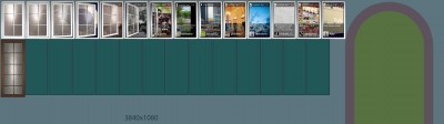

But you can always make the layers equal to the pixels you will use in your canvas to optimize. so at max you would have 7100 x 7100 px - even if its 50 render targets filling your canvas.
Like in my attached scene.. each window (layer) is 210x332 px and filling the layer.
