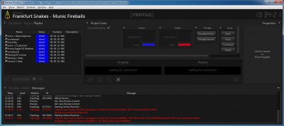

Director has now a configuration file that contains the Topology describing the Ventuz network. If this file doesn't exist, the default topology is created and saved. If one wants to control a non-default Ventuz network, this configuration has to be edited manually.
This will be accessable from a Topology Editor in the future and will provide more flexibilty.
So stay tuned!
- The driven project must exist only once on each system within the network.
- A local machine must be involved in the network
- Director uses VMS service to launch Ventuz on remote and local machines.
- Exactly one single Channel (timeline) must be defined. More or less than one result in an error.
- You should declare two PreviewWindows that connect to the local Cluster
