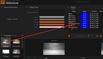

Inside the director, a Template element can be drag&Drop inside the playlist.
Is it possible to get the data Inside a director plugin ?
In DragEnter, GetFormats() give me 5 values (FileDrop, FileNameW, FileName, AssetListDataFormat, DirectorDragDropDataContext). The type of these values are not defined in Ventuz.Director.Shared.

Now i can get value for FileDrop, FileNameW, FileName. Not for AssetListDataFormat and DirectorDragDropDataContext. I don't know if this two values would be usefull.

At this time, drag & drop has not been included to the plug-in SDK. What you are looking for is actually the AssetList in the drop data as it contains a list of URIs which identify the internal Director assets (so for a template something like this: "template://01s1"). However, without also exposing the asset subsystem to the plug-in SDK, we cannot simply publish interfaces to our internal code but have to wrap it for the plug-in SDK, and that will take time. So to sum up: no there is currently no supported way to get that data.

I think i can use data from FileDrop wich contains things like this : ventuz://pages/LineChart_20130805_185454.vpg or ventuz://templates/template\Linechart/Linechart/Linechart.
Also perhaps i can use this.plugin.Application.Show.Templates.GetTemplates() to retrieve data associated with the corresponding FileDrop (by name or .vpg file data perhaps).

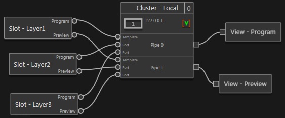

For now i face a problem with channels, here is the configuration of the show :
There is 3 channels but :
Code: Select all
this.plugin.Application.Show.Channels.Count
only returns 1 channel. Any idea ?

Regarding channel count, problem solved. The Director needs to be configured to be able to use the 3 channels.

That's right. The show has to have the correct number of channels, channel slots in the topology are not a 1:1 relationship. For example, you might have a TV studio where there is a display wall, a touch table, an SDI output machine and more. A technician can create a topology that will contain all the hardware and provide it as lets say 4 channel slots. This topology will be used for all projects there and never has to be changed.
The idea is that the operator creates a show, uses the existing topology and just says "hey, for my project I'll just use one channel and connect it to the "wall" channel slot. Another operator comes, has a different project that might require to channels, one on the wall and on to drive the touch table. So his show has two channels and he uses 2 channel slots out of all the available slots in the topology. In a event-scenario (non broadcast), it's much more likely that the person that creates the topology and the person that operators Director will be the same person and the topology is only used for that single project. So in this case channels and slots are 1:1.
