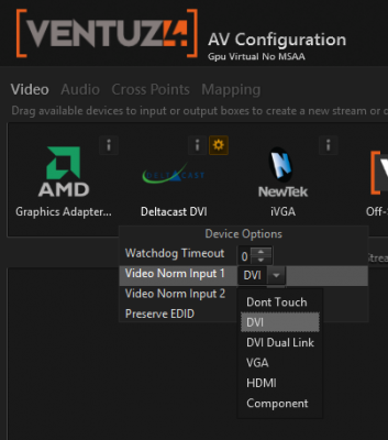

If the first input is configured to dual link the second input can not work.
Please check the AV configuration. Click on the sprocket above the Deltacast DVI Board and check the Video Norm settings.
Setting these to HDMI can often resolve a lot of problems.

Of course, I tried this option.
To version 4.5.02 everything worked perfectly.
After completing the upgrade to version 4.06 this problem appeared.
Card behaves as if all the time was under DualLink - despite changes in AV Configuration option.

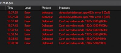

No DVI inputs working
Post by joysprod » 26 Jan 2015, 17:15
I cant get any DVI inputs working using Deltacast input card. Was fine in 4.05.
Errors reported as

The new Deltacast 5.17 SDK that came with Ventuz 4.06.00 has a changed behavior when setting the dual link flag. No driver update will be required to fix this.
I haven't had the opportunity to check this on a V2 board (with dual link), but I could reproduce something similar on the V1 board (without dual link).
Should be fixed with Ventuz 4.06.01 soon.
