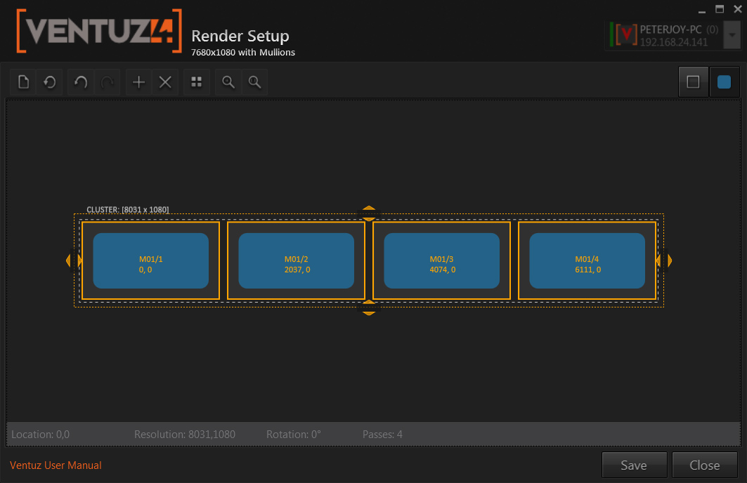

Im a little confused on a few parts of the screen shaping. Not certain if negative space between outputs is supported at the moment. It does not require blend or shape, but I am confused.
1) In version 3 you would make a couple of custom render layouts in the Project properties. I would make a design and a production set up and when making a VPR make certain I was on the correct one before saving. Do I still need to make custom layouts or is all of that accomplished by the Configuration Editor.
In version 4, a design and production setting are already in the Stage Editor. Selecting Production Preview gives me exactly what I require in the renderer window. Exporting this to a VPR however always give me the Design Preview look showing the negative space mullions. Am I missing something?
2) When configuring a single machine 4 monitor setup, I see that it takes 4 passes when using negative space between the monitors, but only 1 pass if all screens are butted together.
What exactly does the passes mean? Is this less efficient than the V3 way of doing it with 4 shape surfaces and a render target?
Regards
Peter

Re: Screen Shaping
Hi!
The blue 'passes' show the areas of continuous rendering:
http://www.ventuz.com/support/help/late ... erformance
Cheers!
Cheers!
