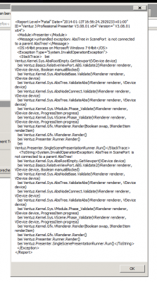

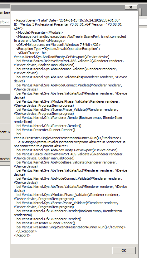

sometimes (maybe 1 of a 100) I get an "Abstree in Sceneport is not connected to parent Abstree!" exception... which is unhandled.
What could this mean?
Unhandled exception
Re: Unhandled exception
this is a mysterious error which is reported now and then by our Error Reporting dialog. But we cannot reproduce it.
And it only occurs in Presenter. Could be related to scene loading timing.
We have re-written the Presenter start-up procedure for Ventuz 4 and it seems that this bug has been eliminated.
