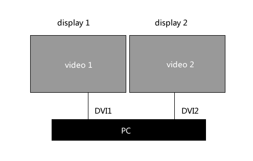

For example,there are two videos which both need to be played by fullsreen mode in the same time,so does ventuz support multiple render windows(different content) in one vpr ?

hi allen
i dont get your question ;( 2 videos in fullscreen mode at the same time? can you explain a bit more?

Re: Multiple render windows
just consider your two displays being one screen. Set the render size of the project to the resolution of this whole screen. I.e. if your two displays are 1920*1080, set the render size to 3840*1080. Now take care of your problem in the scene. For example use two viewports, each being half the size of the whole screen and attach a video node to them.
In order to see the fullscreen mode across both displays, you need to set up your graphic card to treat them as one. I think AMD calls this option "Eyefinity/Display Group", Nvidia calls it "Mosaic".
Regards
Götz
