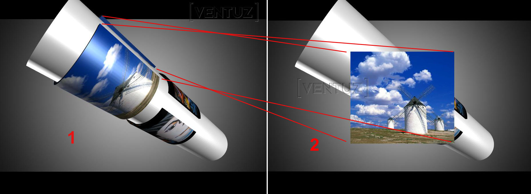

I want to unwrap a wrapped geometry or view port like in the attachment.
Didn´t find something about in the manual (rtfm) or in the entire example scenes.
What´s the way or is there a link to a similar thread or an (unseen) example?!
Regards M.
Wrapped - Unwrapped...as animation

The best way is to use only one OBJ file. In your 3D modelling package convert every frame of your morph animation into a polygon mesh. Frame for frame. The best way to do this is with a script. Delete everything else in your scene so you are only left with the meshes from each frame in the order of the animation. Export as ONE obj file and access each individual mesh using the subset property in the Ventuz Mesh node. You can control and animate the animation using that property. This way your entire animation is in ONE obj file that is loaded once and you are not constantly loading different OBJ files.

Sounds logical. Tried that out but there was only one frame (of 25 = 1sec) imported. Made it like you described it in detail. To split it in 25 keyframes I had to make a PLA operation in c4d. So I guess the problem is in my 3d file.
